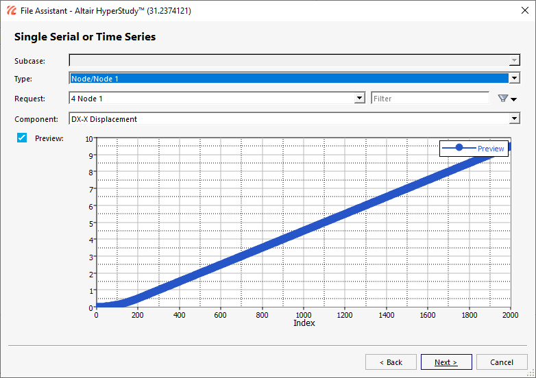

  2. Create a data source labeled Disp_sim.
    1. From the Study Directory, drag-and-drop the TENSILE_TESTT01 file, located in approaches/setup_1-def/run__00001/m_1, into the work area.
    2. In the File Assistant dialog, set the Reading technology to Altair® HyperWorks® and click Next.
    3. Select Single Item in a Time Series, and then click Next.
    4. Define the following options, and then click Next.
      • Set Type to Node/Node 1.
      • Set Request to 4 Node 1.
      • Set Component to DX-X Displacement.
      Figure 11.
    5. Under Create a new Data Source, enter Disp_sim in the Label field.
    6. Clear the Use Data Source in a new Response checkbox.
    7. Click Finish.
      Figure 12.

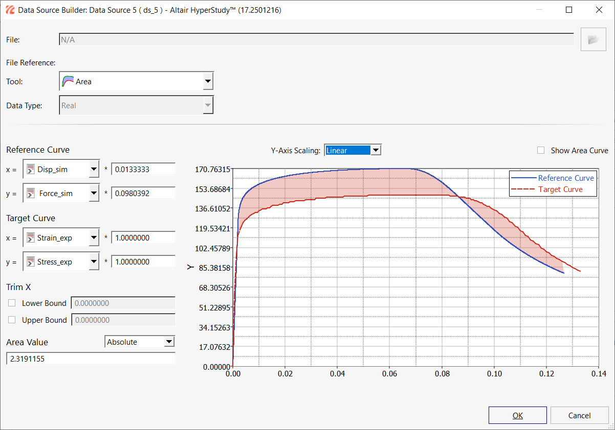

  6. Define the Area Between Two Curves output response.
    1. In the Expression Builder, click the Data Sources tab.
    2. Click Add Data Source and choose Area from the Tool options.
    3. In the Label field for the new data source, enter Area Difference.
    4. In the File column, click .
      In the Data Source Builder, there are Curve 1 and Curve 2 options for simulation and experimental curve data. Each has x and y data sources entered differently.
      Curve 1_x = Disp_sim
      Curve 1_y = Force_sim
      Curve 2_x = Strain_exp
      Curve 2_y = Stress_exp
      The displacements and forces are read from the simulation, whereas from the experiment you have strains and stresses. In order to convert the displacement and forces to strains and stresses, you need to divide the displacements by the length (75) and forces by the area (10.2). Use the scale factor box to define conversions. For displacement, the scale factor is 1 75 MathType@MTEF@5@5@+= feaahqart1ev3aaatCvAUfeBSjuyZL2yd9gzLbvyNv2CaerbuLwBLn hiov2DGi1BTfMBaeXatLxBI9gBaerbd9wDYLwzYbItLDharqqtubsr 4rNCHbGeaGqiVu0Je9sqqrpepC0xbbL8F4rqqrFfpeea0xe9Lq=Jc9 vqaqpepm0xbba9pwe9Q8fs0=yqaqpepae9pg0FirpepeKkFr0xfr=x fr=xb9adbaqaaeGaciGaaiaabeqaamaabaabaaGcbaWaaSaaaeaaca aIXaaabaGaaG4naiaaiwdaaaaaaa@383E@ . For the area, the scale factor is 1 10.2 MathType@MTEF@5@5@+= feaahqart1ev3aaatCvAUfeBSjuyZL2yd9gzLbvyNv2CaerbuLwBLn hiov2DGi1BTfMBaeXatLxBI9gBaerbd9wDYLwzYbItLDharqqtubsr 4rNCHbGeaGqiVu0Je9sqqrpepC0xbbL8F4rqqrFfpeea0xe9Lq=Jc9 vqaqpepm0xbba9pwe9Q8fs0=yqaqpepae9pg0FirpepeKkFr0xfr=x fr=xb9adbaqaaeGaciGaaiaabeqaamaabaabaaGcbaWaaSaaaeaaca aIXaaabaGaaGymaiaaicdacaGGUaGaaGOmaaaaaaa@39A1@ .
      Figure 13.
    5. For Curve 1, enter 0.0133333 in the scale factor box for x as shown in Figure 13.
    6. For Curve 1, enter 0.0980392 in the scale factor box for y as shown in Figure 13.
    7. Click OK to close the Data Source Builder.
