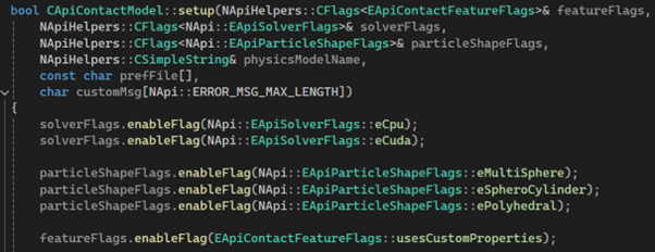

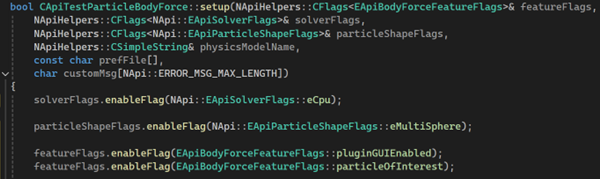

Examples

- For a contact model plugin that uses the CUDA solver, for every particle
shape and custom properties, use the setup flags as follows:
- For a particle body force plugin that uses the CPU solver, the Multi-Sphere
particle shape, and the plugin GUI, and calls the particle of interest
function, use the setup flags as follows:
