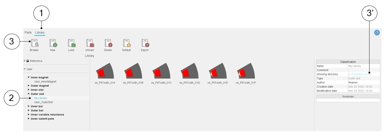

From the Library environment, it is possible to directly access the folder in which the data dealing with the selected library are stored.
Table 1. Browsing to access the library folder
1 Selection of the library area of the Part Library application.
2 Selection of a library.
3 Browse function is available from the top part of the environment. Browse allows reaching directly the folder in which stored data of the selected library is available.
3' Browse function is also available from the information table.
Note: Browse can be reached by right Clicking on the considered library via a drop-down menu where functions such as Browse, Default, Rename, Unload and Delete are available.

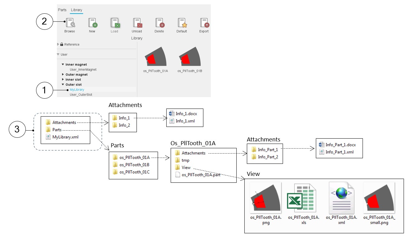

Table 2. Browsing to access the library folder and contents of folders
1 Selection of a user’s library. In our example the name of this catalog is “MyLibrary”.
2 Click on the icon “Browse” to reach the folders dealing with the part.
3 Content of the folder “MyLibrary”:
Two folders’ “Attachments” and “Parts” + one xml file: MyLibrary.xml.
Note: In the folder “Attachments” there are all the documents associated with the considered library (or part).
In the folder “Parts” there are all the parts stored in the considered library.
