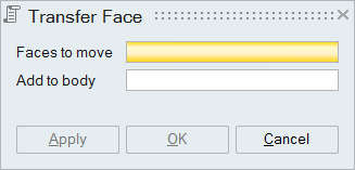

This option is used to move the faces from its parent body to given reference body.
Faces to move
Select the input faces to move. Faces should not be selected from the reference body.
Add to body
Select one reference body

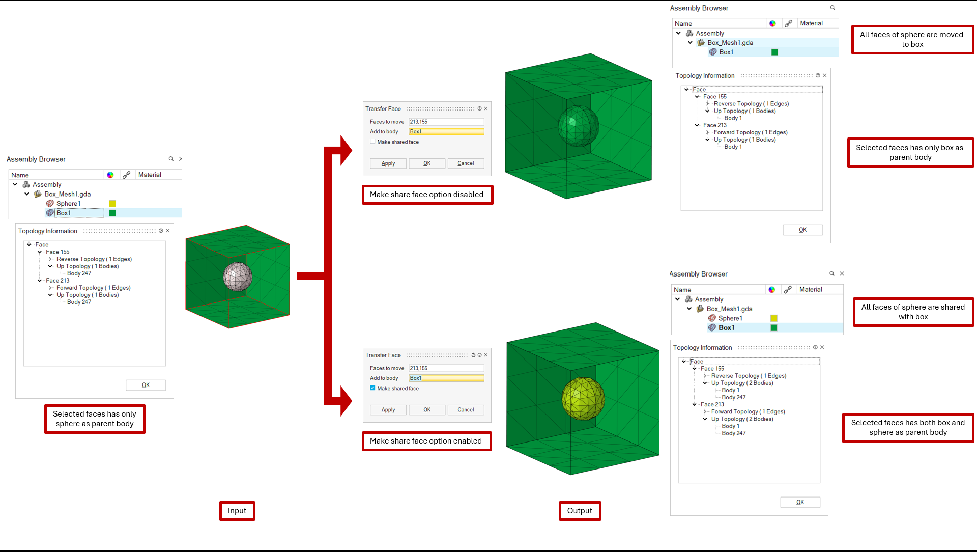

Make shared face
Toggle ON to share the selected faces with the reference body instead of transferring them.
Example 1
Faces to move
Reference Body
Output
Example 2
