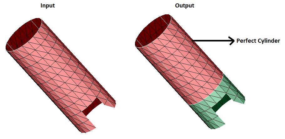

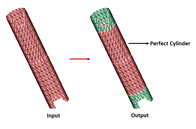

This tool is used to extract the perfect cylindrical portion from a cylindrical pipe.
By perfect cylinder, which implies that it is a cylindrical portion which has parallel circular edges on its both ends.
The selected cylinder must have at least one proper circle. Once this dialog is opened the cylinder face filter is enabled.
If the cylinder face has the attributes then it is enough to pick only one face of the cylinder. Otherwise user has to pick all faces of the cylinder.
Only one cylinder can be extracted at a time.
Example1
Example2
