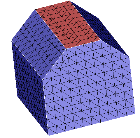

Example 1
In this example the selected face is offset for a negative distance with duplicate option.
Input
Output
(actual body shown in transparency) Move boundary along neighbor faces - OFF
Move boundary along neighbor faces - ON

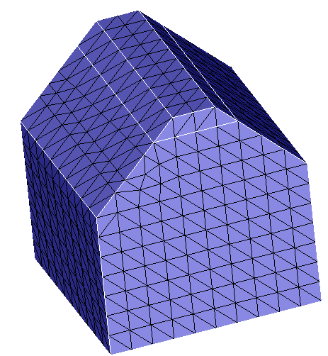

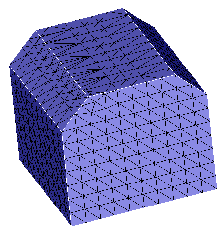

Example 2
In this example the selected face is offset without duplicate option.
Input
OutputOffset for a negative distance.
Offset for a positive distance.
