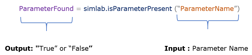

This utility is used to check the availability of SimLab parameters in database.
Syntax
ParameterFound = simlab.isParameterPresent("ParameterName")

Utility Input/output

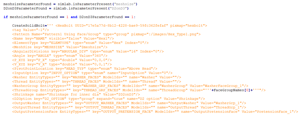

Sample
Note: Sample Script
