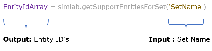

EntityIdArray = simlab.getSupportEntitiesForSet('SetName')

Utility Input/output

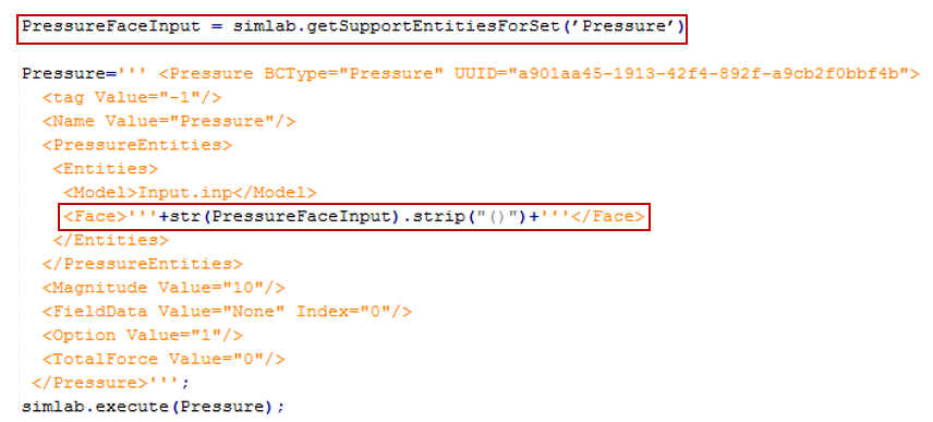

Sample
Note: Sample Script
