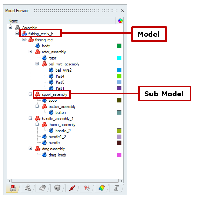

This utility is used to get the Sub Model or Bodies of a Model or Sub Model.
Syntax

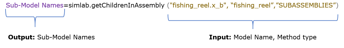

OutputList = simlab.getChildrenInAssembly("ModelName","ModelName or SubModelName","Method Type(SUBASSEMBLIES or BODIES or ALLBODIES)")
Method Type
- SUBASSEMBLIES It returns the first level child sub models of the given model name or sub model name
- BODIES It returns the first level bodies of the given model name or sub model name
- ALLBODIES It returns all bodies of the given model name or sub model name

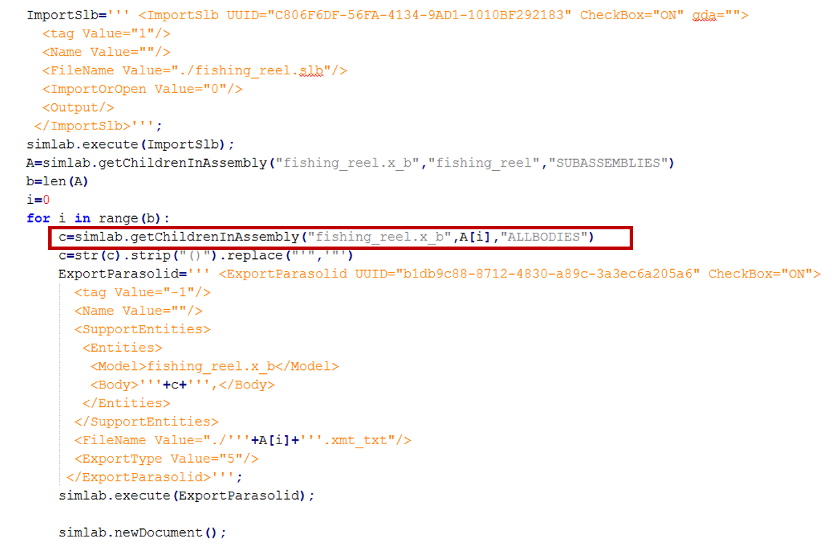

Why we need this utility?
In case of assemblies having large number of Sub Assemblies, and we need to get each Sub Assembly as a separate database and work on them individually, we can use this utility to get the Sub Assemblies and export as separate database.
Utility Input/output
Sample
Note: Sample
Script
