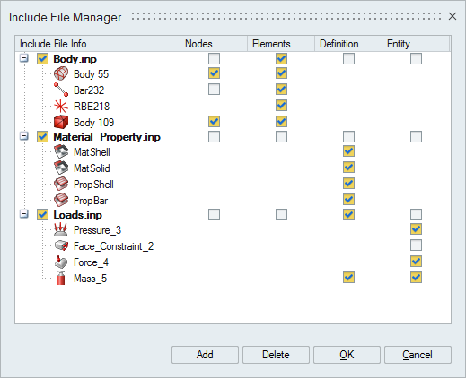

Include File Manager
This tool is used to organize the model data into various include files. While doing the solver deck export, the include files are written based on this include file manager.
Currently, this is supported for following solvers:
- Abaqus
- OptiStruct/Nastran - Only nodes and elements

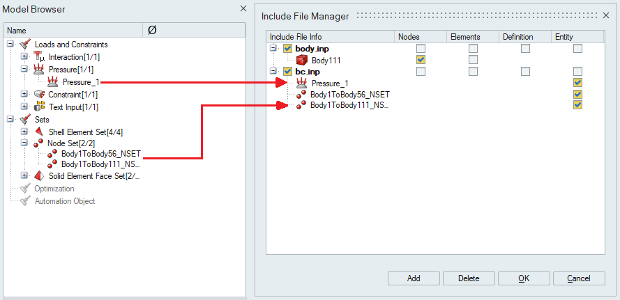

- Drag the required entities (bodies, contacts, loads & constraints,
material, property, sets) from the browser and drop it to the required
include file in the include file manager.
- Turn ON the Nodes/Elements/Definition/Entity toggles to write the respective data in the respective include file.
- Turning OFF the include file name toggle will skip exporting the include file, but it will include the file name in main solver deck.
- User can edit the default name given to include file.
