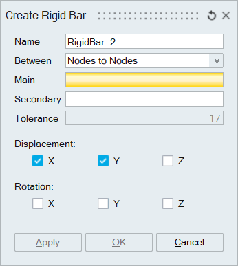

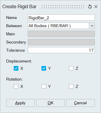

Rigid Bar
This tool is used to create Rigid bar elements.

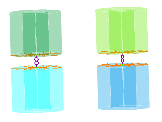

Example

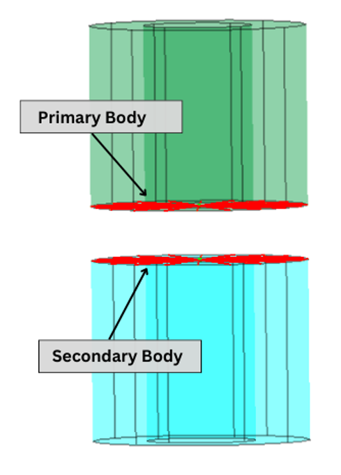

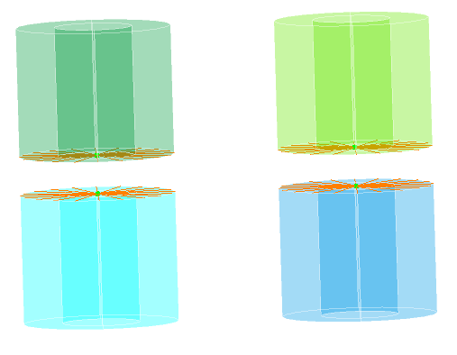

- Using Two Bodies (RBE/BAR)

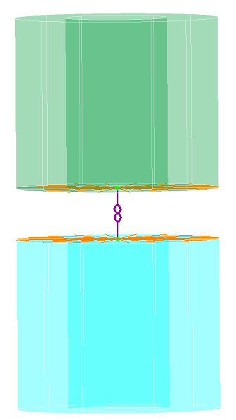

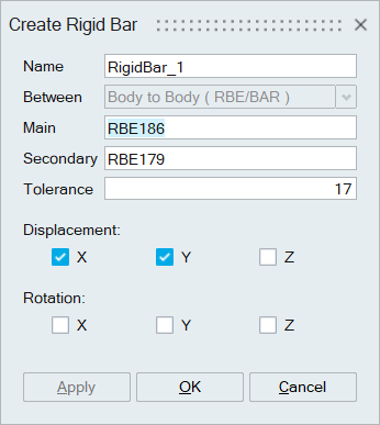

Using Two Bodies (RBE/BAR) - Using All Bodies (RBE/BAR)
Cards supported for various solvers
| Solver | Supported Cards |
| Nastran/OptiStruct | RBAR |
| Abaqus | *MPC (Beam elements) |
| Ansys | CERIG, CP |
Note: Tolerance is exposed only for the Two Bodies (RBE/BAR)
and All Bodies (RBE/BAR) option.
