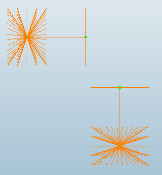

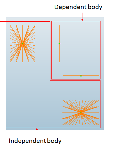

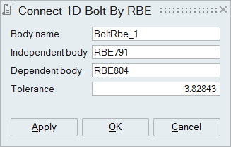

It connects the independent and dependent rigid bodies using rigid body elements. The master nodes of rigid body elements of dependent and independent body within the specified tolerance are identified and connected by rigid body elements.
