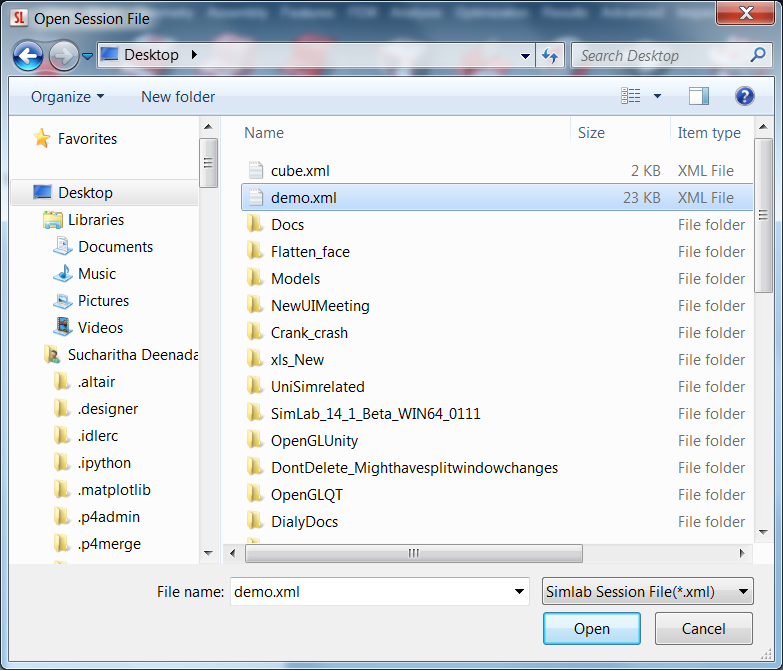

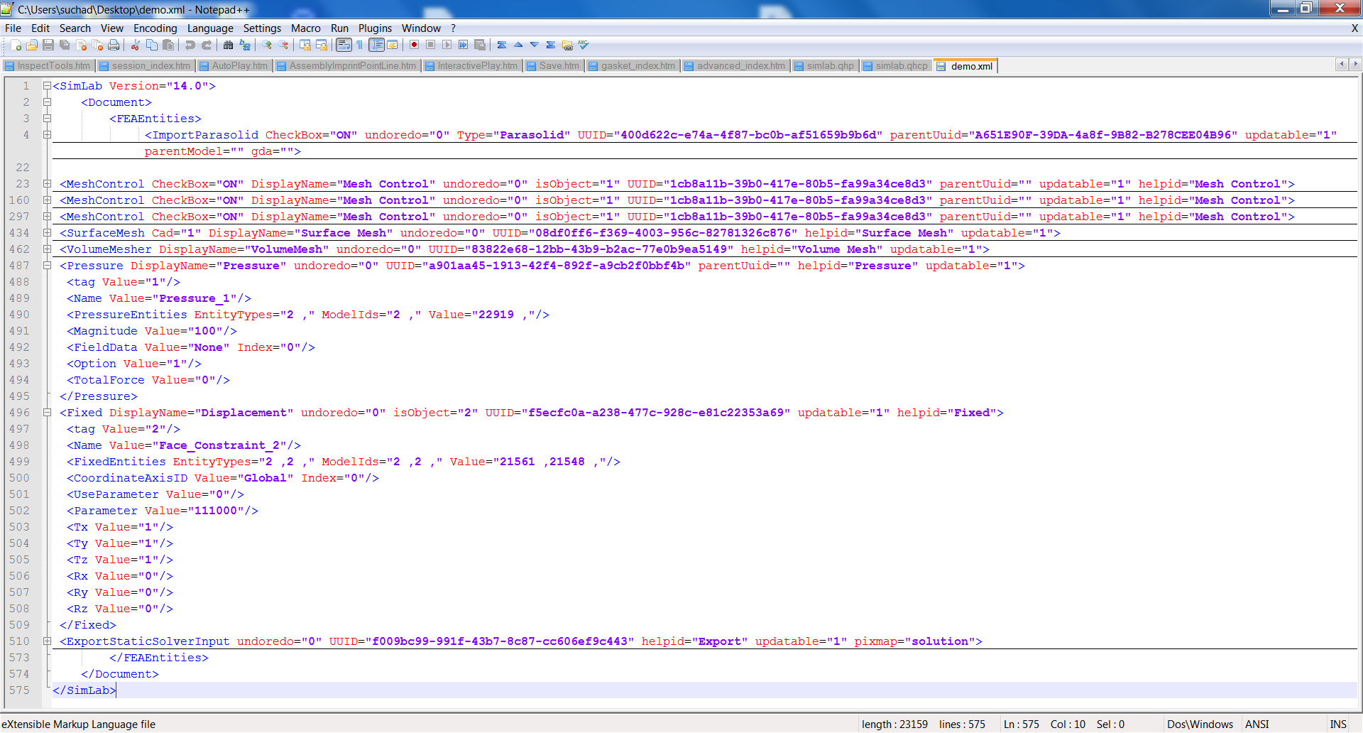

  • SimLab Session files are used to capture all the functionalities that are done on the database in the form of the Domnodes in the XML.
  • This option is used to play each functionality automatically from start to end.
  • The input is an xml file in the form of the domnodes with the values in sequence.
  • It performs the operations with the parameter values if specified.
