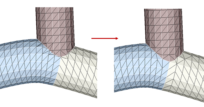

This tool is used to cleanup the pipe connections after Outer Skin for pipes. Minimum element size is used to collapse one layer of element edges failing the specified size. Collapse non-vertex nodes option uses the average element size of the input bodies to collapse the non-vertex nodes.
Note: The axial flow lines must be topological edges in order to collapse the non-vertex nodes along connections.
