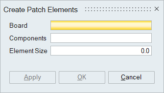

This tool is used to create patch elements between the board and components. The patches will be created along the sharp corners of the components that overlaps with the board. Element sets are automatically created for each component.
Note: If the components are merged using Merge Bodies tool, sets will be
created separately based on the original body name.

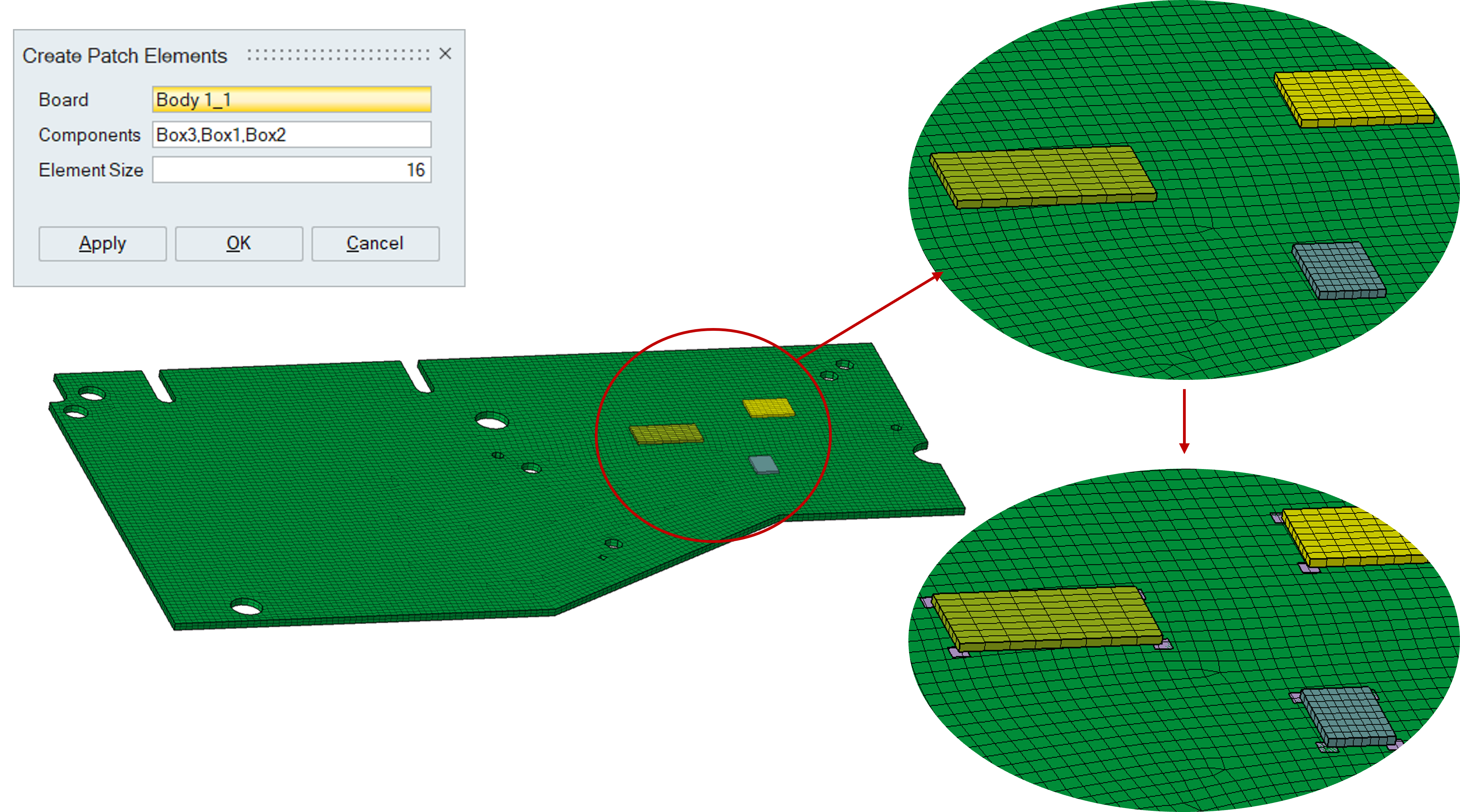

Example
