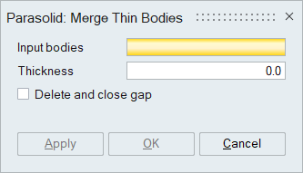

Input bodies
Users need to select the input bodies that contain the thin bodies along with their adjacent bodies. Merging will happen only between the bodies chosen as the input.
Thickness
Thickness needs to be specified to identify the thin bodies.
Delete and close gap
If the thin body has a different shape than that of its adjacent body, merging will result in unwanted sections added to the adjacent body. This option is used to overcome that by deleting all the thin bodies and closing the gap that is created after deletion.

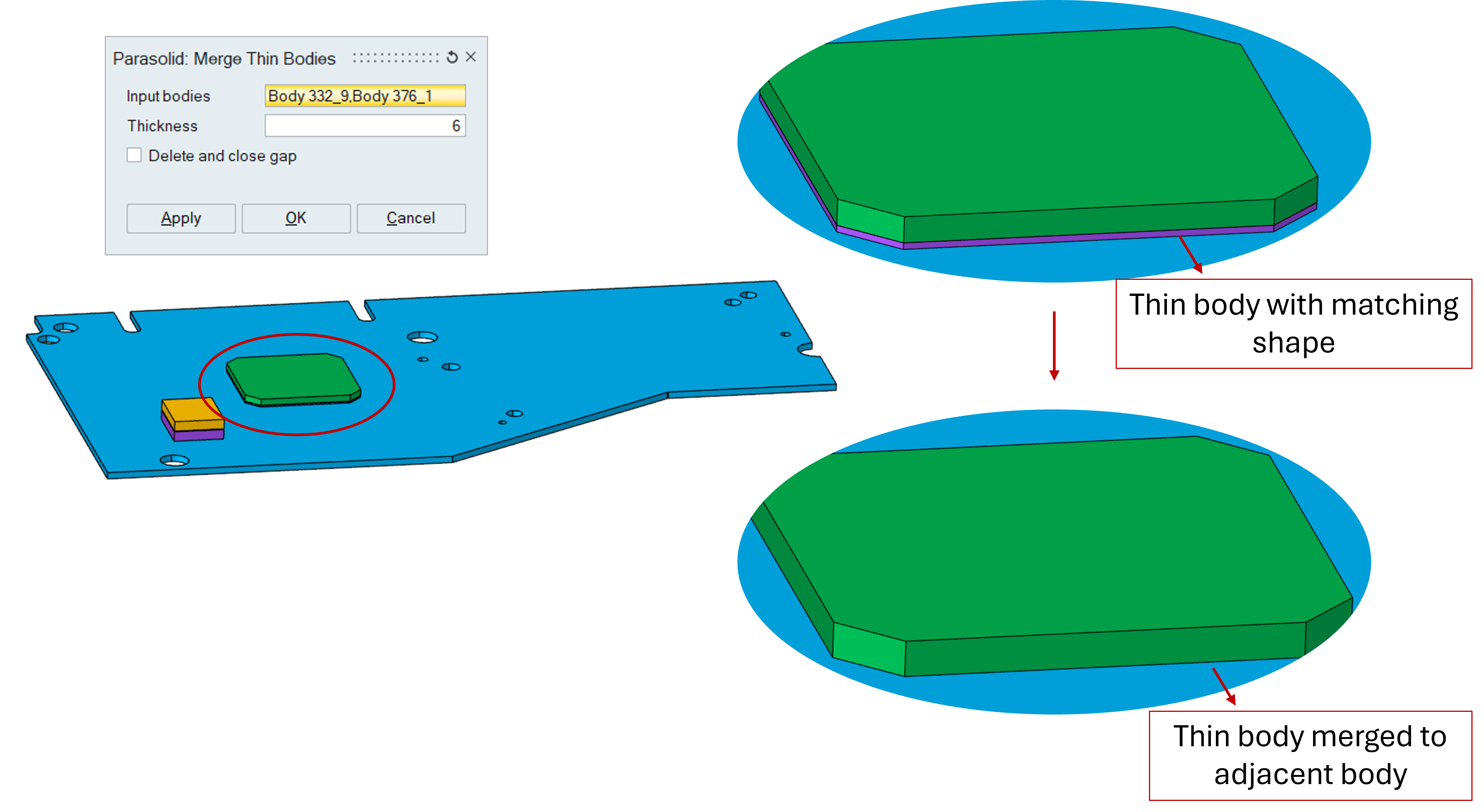

Example 1: Delete and close gap – OFF

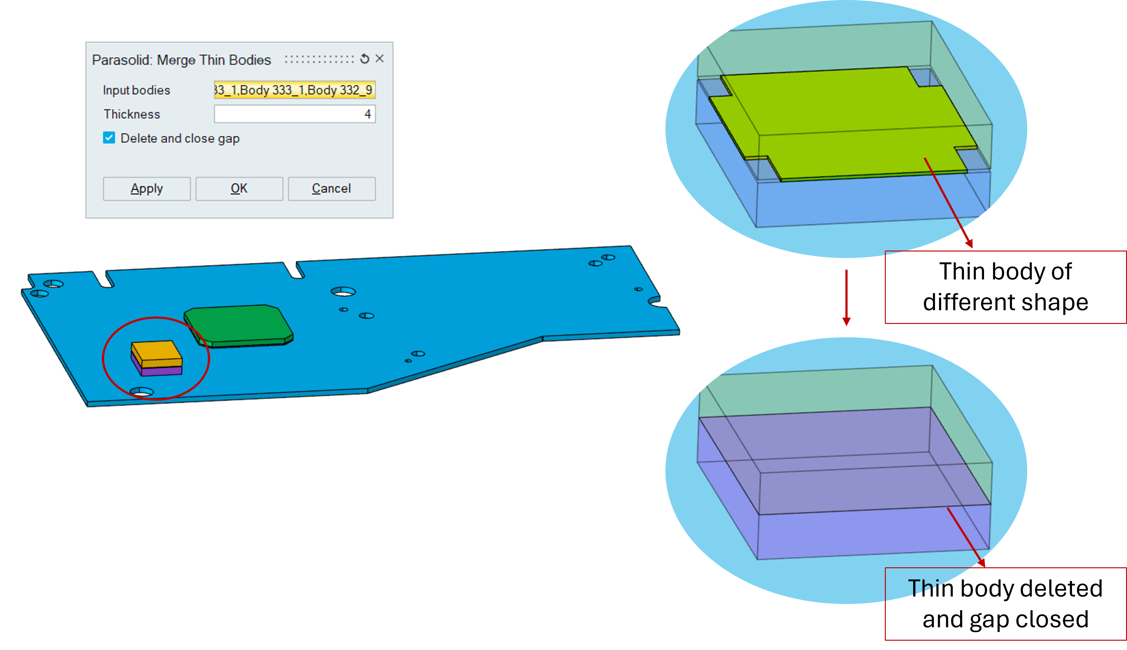

Example 2: Delete and close gap - ON
