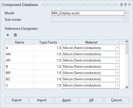

This tool is used to modify the material details of a component based on its Reference Designator.
Model
Select an ECAD model to review the layer properties.
Sub Model
This option allows to review the layer information of sub-models.
Note: In the case of a merged ECAD model (where two or more ECAD models are combined and categorized as sub-models), the listing displays the board bodies from each sub-model group separately. This facilitates the user in reviewing layer properties for each ECAD sub-model
It is a unique identifier used to specify the location of a component within an electrical schematic or on a printed circuit board.
Type Factor
It is a constant based on type of the electronic component, typically varying between 0.75-2.25.
Export and Import
For Manual entry of Component information, Import and Export of CSV file is supported.
