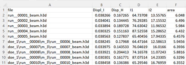

  1. Open the collected_data.csv file.
    This file summarizes the relative locations of the different .h3d files provided. Also, the KPI values corresponding to each .h3d file are listed in the columns with an appropriate header. Anyone can edit this file to add or remove KPIs.
    KPI Summary Contained in the CSV File
  2. Verify the relative path to the .h3d file is correctly input in the first column and that each .h3d has all the KPIs defined.
