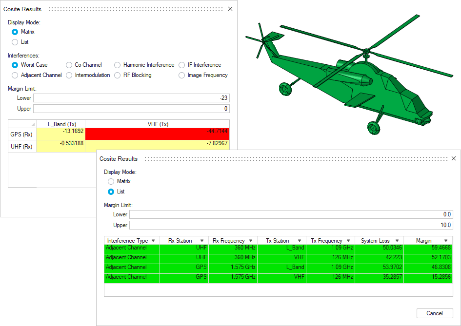

This example shows how to set up a co-site interference solution Altair SimLab. The example uses S-parameter data from an external Touchstone file.
First we will set up an solution to analyse the interference between the transmitter and receivers connected to the antennas, and then show how to mitigate this interference by adding additional filters to the receivers or transmitters.
