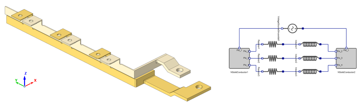

SimLab Tutorial: SCAC Busbar
The tutorial present how to use the SimLab-EM solution to model an electric vehicle busbar and run a basic electromagnetic analysis by an AC Supplied Conductors solution (by a new integral method-based EM solver).

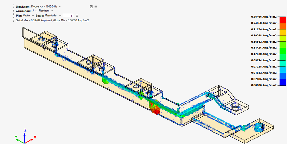

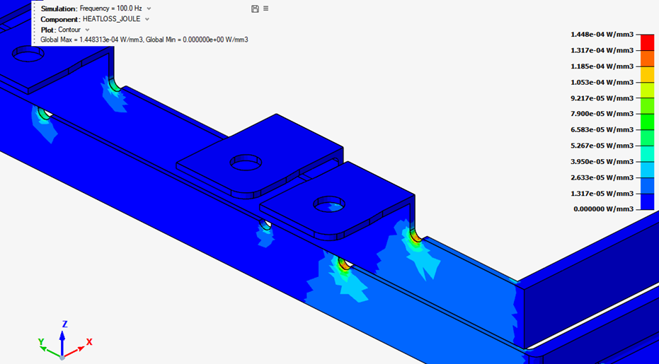

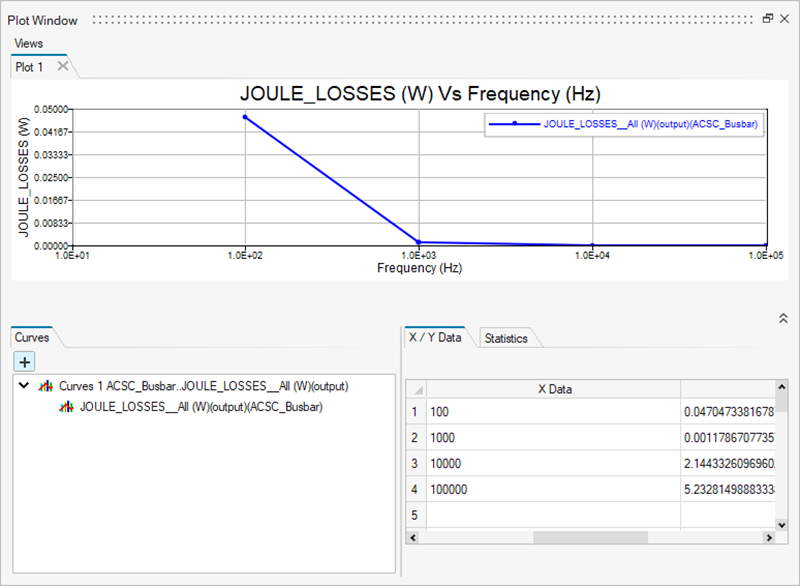

Analysis
The electromagnetic analysis is performed in the frequency domain, by using the SimLab AC Supplied Conductors solution.
Results
