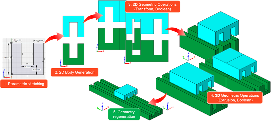

Geometry modeling
Starting from the SimLab sketcher, users can implement 3D parametric geometry modeling in SimLab by using 2D and 3D geometric operations. The geometric modeling process for this device is as follows:

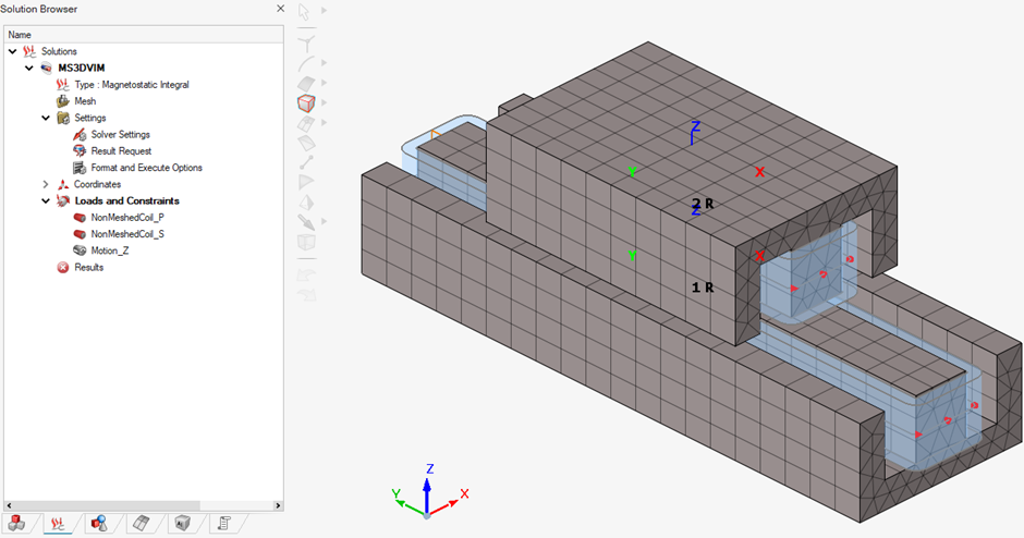

Since the integral-method-based 3D magnetostatic solution does not need to consider the surrounding air region, in the physical definition, only the moving part (motion) and the excitation source (non-meshed coils) need to be considered, as shown below:

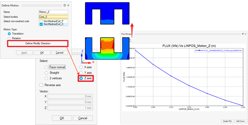

Study 1: mutual inductance versus distance
The direction of motion is controlled by Motion LBC. The following is the mutual inductance curve when the motion is defined in the Z-direction (distance).

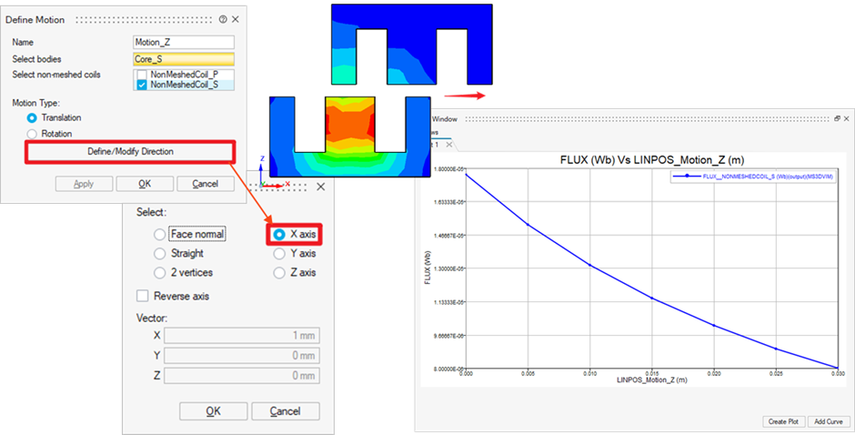

Study 2: mutual inductance versus misalignment
The direction of motion is controlled by Motion LBC. The following is the mutual inductance curve when the motion is defined in the X-direction (misalignment).

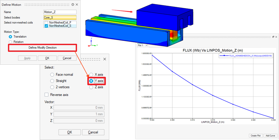

Section3: mutual inductance versus movement
The direction of motion is controlled by Motion LBC. The following is the mutual inductance curve when the motion is defined in the Y-direction (movement).
