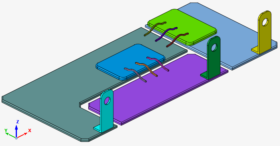

As shown below, the studied device is a power electronic module component. The entire module is assumed to be made of conducting material and the goal is to compute the Z and S parameter.

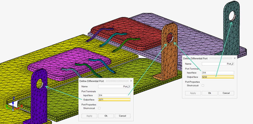

SimLab-EM provides a very convenient power module meshing tool and simple circuit connection method, as shown below:

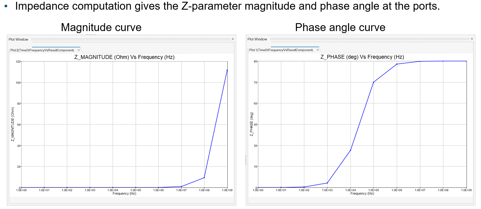

After the simulation is completed, based on the integration method, users can obtain the results of S parameters and Z parameters:
