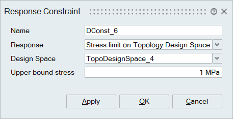

Response Constraint is used to define system responses and apply constraints on them, forming the basis for setting up an optimization problem.
  1. Response Constraint is used to constrain the Response/Response Equation. Also Stress limit on Topology design space can be defined, if topology design space is defined.
    • The Subcase independent constraints will be treated as Global Response Constraints.
    • If Subcases are not defined, then the dependent constraints are included in the first Subcase by default.
    • If Subcases are defined, then the dependent constraints should be defined for each Subcase in the Response Constraint dialog.
