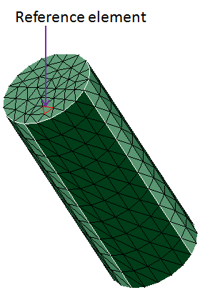

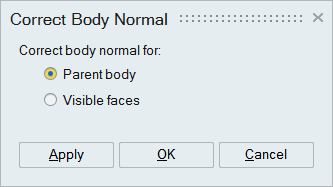

This is used to change the orientation of faces using the given reference element normal.
Parent bodyReference element parent body faces normal will get corrected.
Visible facesOnly connected visible faces normal will get corrected.

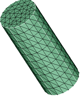

Example
Input
