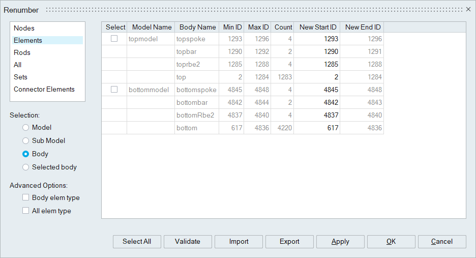

Elements
Option to renumber elements in FE models.
Selection
  • Model: FE models in the Model browser will get listed in the renumber window. You can select the models to renumber and set New Start ID.
  • Sub Model: Root sub-models under each FE model get listed in the renumber window. You can select the model to renumber and set the New Start ID for each root sub-model.
  • Body: Bodies under each FE model get listed in the renumber window. You can select the model to renumber and set New Start ID for each body.
  • Selected body: You can select the bodies that need to be numbered and set the New Start ID. In this case, if the given ID range conflicts with the unselected body elements, those unselected body elements will get renumbered to a unique maximum ID.
Advanced Options
  • Body elem type: This allows you to set the numbering range for the elements based on body type separately.
    1. Only 2D elements from shell/sheet bodies listed for numbering.
    2. Only 3D elements from solid bodies listed for numbering.
    3. Only 1D elements from BAR/RBE/wire bodies listed for numbering
  • All elem type: This allows you to set the numbering range for all the available element types separately.

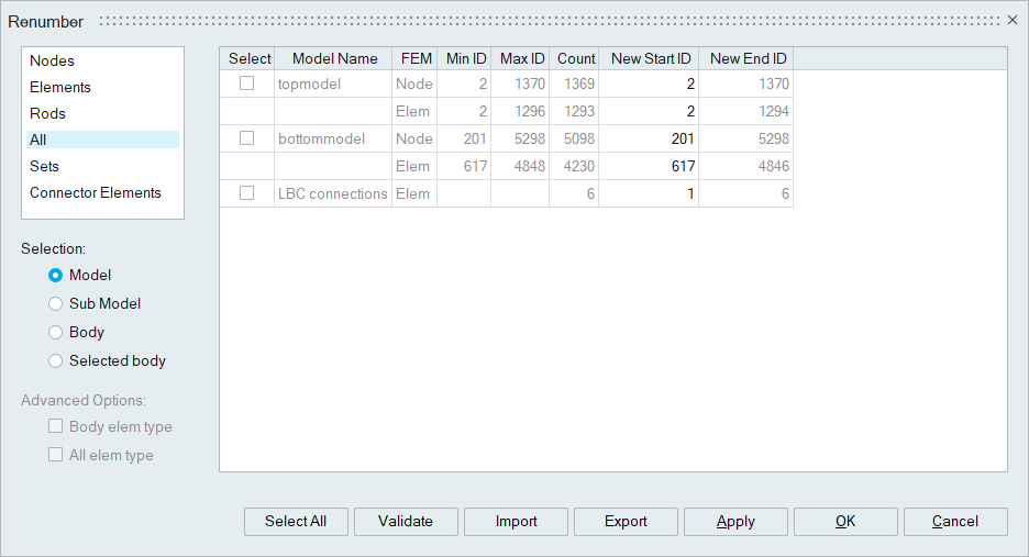

All
Option to renumber nodes, elements and rigid bars collectively.
Selection
  • Selected body: You can select the bodies that need to be numbered and set the New Start ID. In this case, if the given ID range conflicts with the unselected body nodes or elements, those unselected body nodes or elements will get renumbered to a unique maximum ID.

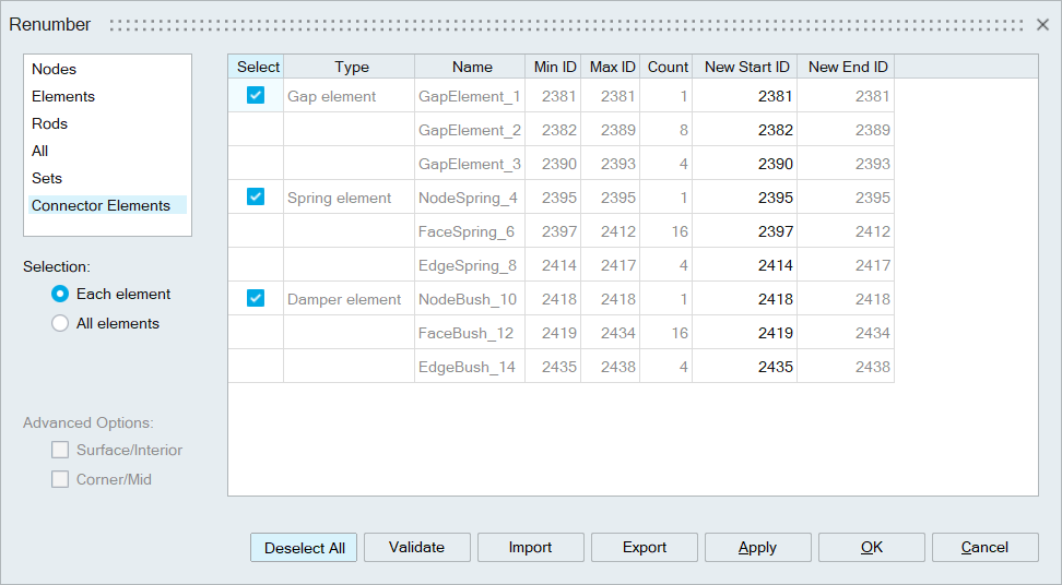

Connector Elements
Option to renumber the following connector elements.
  1. Gap Element
  2. Spring Element
  3. Damper Element
Selection
  • Each element: Each connector element is listed in the renumber window. You can set the numbering range for each connector element separately.
  • All elements: All Spring or Gap Elements can be renumbered collectively using this option.
