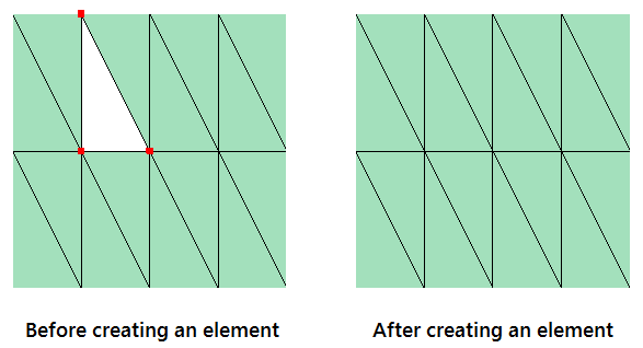

Example
The element is automatically created once the required number of nodes is selected.
