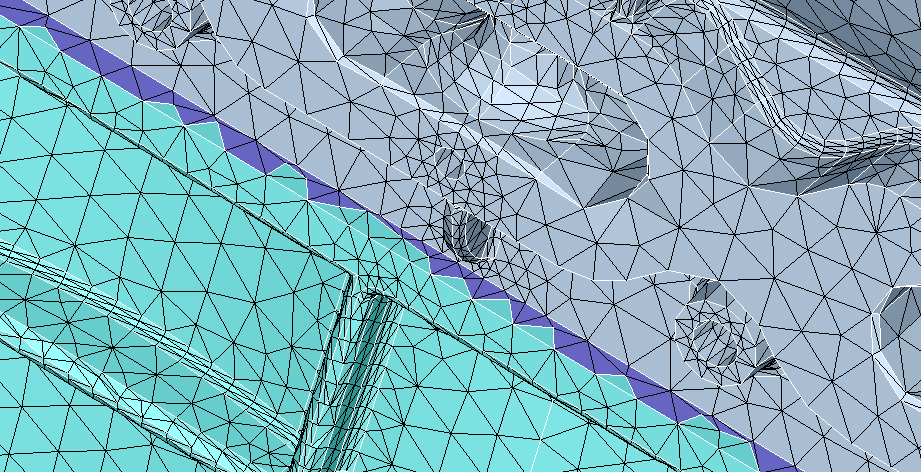

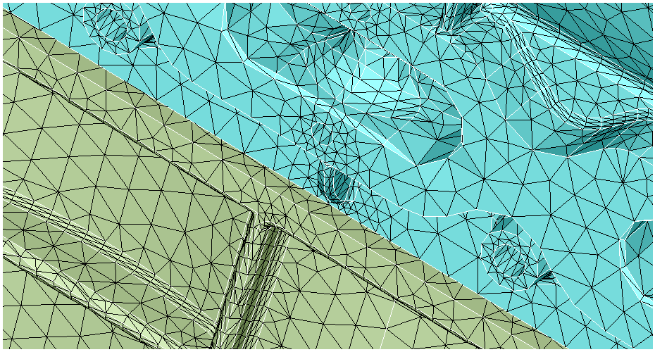

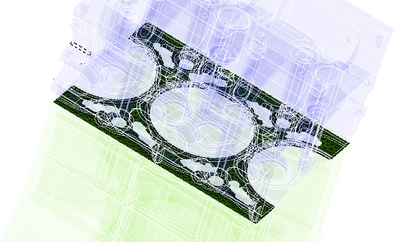

This tool is used to connect the bodies that intersect, penetrate, or lie within the gap tolerance.

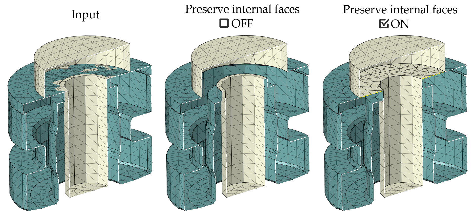

  • Preserve internal faces
    This toggle will be enabled only when two bodies are selected. When this toggle is turned ON, the internal faces of the first selected body will be preserved.
