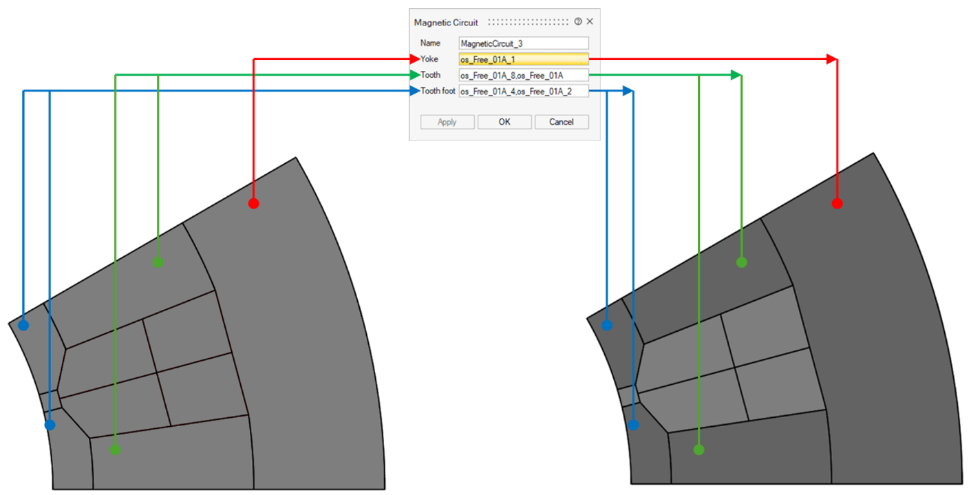

Magnetic Circuit
Assign bodies with magnetic lamination properties to the Magnetic Circuit Region. The Magnetic Circuit must be divided into three subcategories: Yoke, Tooth and Tooth foot. The Apply / OK action is enabled only if the three subcategories are assigned. Each sub-category can be assigned individually or in groups; assigned bodies turn dark grey.
Note: Magnetic Circuit Region material is set in FluxMotor.
