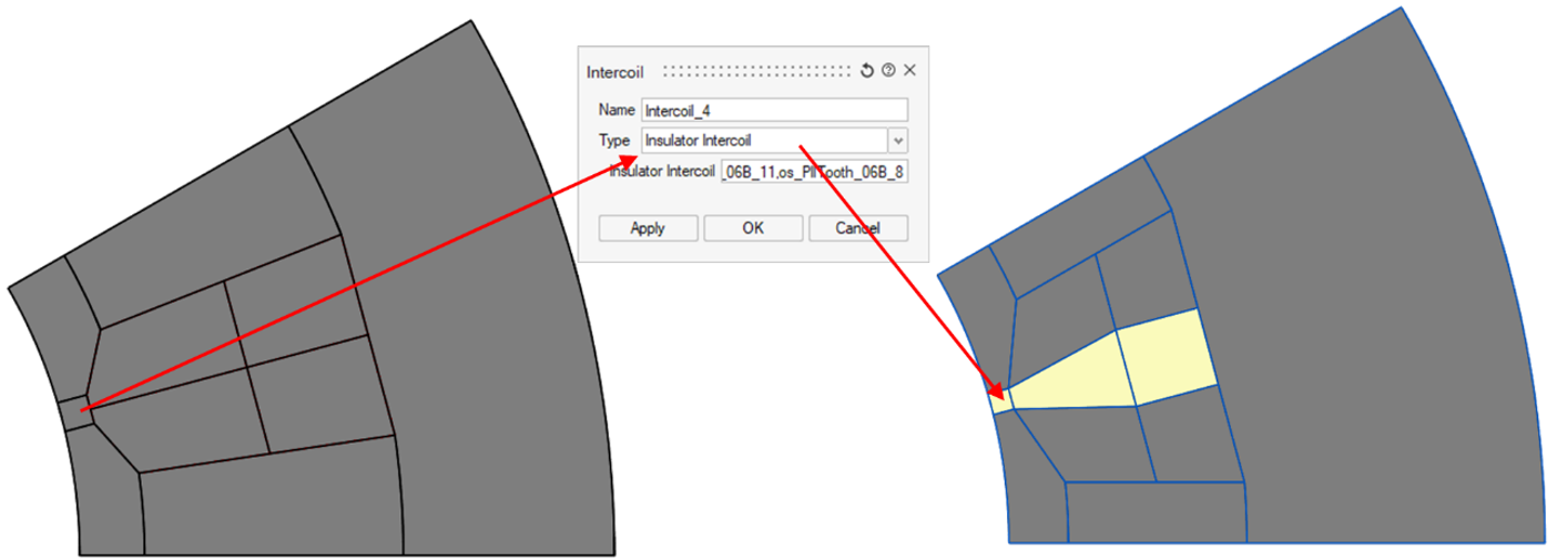

Assign bodies with intercoil properties to the Intercoil Region. Assign individually or in groups.
Users can select three different types of Intercoil: Fluid
Intercoil, Insulator Intercoil and
Ferromagnetic Intercoil.
- If the Fluid Intercoil is selected, bodies turn light blue.
- If the Insulator Intercoil is selected, bodies turn
light yellow.

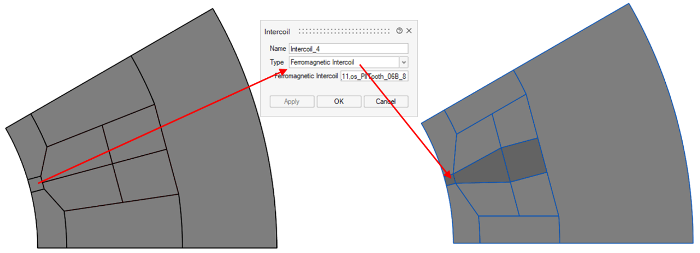

- If the Ferromagnetic Intercoil is selected, bodies
turn dark grey.
