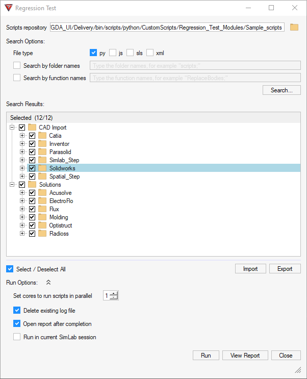

This tool is used to run regression test for SimLab using scripts in batch mode (Python, Jscript, XML & SLS).
Sample script will be loaded by default. User can point to their own scripts repository and run the test.
- Scripts repository: Browse and select the root folder where all the test scripts are available.
- Search Options
- File Type: Select the required script format (python-"py", Java script-"js", XML-"xml", SimLab script-"sls")
- Search by folder name: This option is used to search scripts from specific folders present in the repository. Use semicolon ";" to specify multiple folder names.
- Search by function name: This option is used to search scripts based on specified function names. Use semicolon ";" to specify multiple function names.
- Search: Click on search button to find the scripts from the repository based on search inputs.
- Search Results: The searched scripts will be listed as a tree structure with a checkbox. Users can choose the required scripts.
- Import / Export: User can export the selected scripts as spec file(.json). Later it can be imported to run the same test again.
- Run Options
- Set cores to run script in parallel: Specify the number of physical cores to run the selected scripts in parallel. By default, it is set to one core.
- Delete existing log files: This option will delete the existing script log file present in the script location. This will avoid appending the log in the same file again.
- Open report after completion: This option will automatically open the report once the test gets completed.
- Run in current SimLab session: This option will run the selected scripts one by one in the current GUI session.

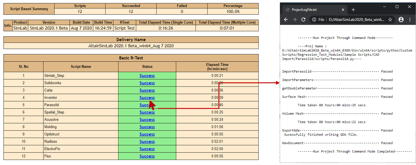

- View Report / Status: This option is used to view the report after completion or to view the status while running.
Report Format
