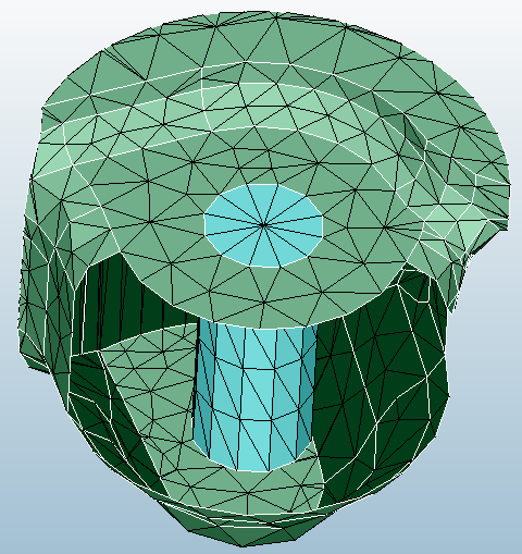

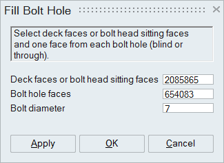

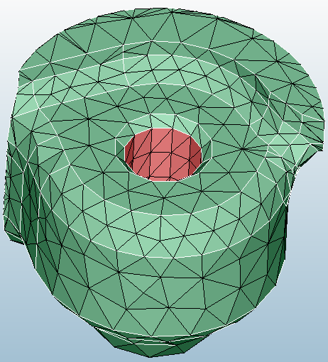

Blind or through bolt holes can be filled with TET elements using this tool. More than one bolt holes can be filled by selecting one face from each bolt hole. The resulting TET mesh in the bolt holes will have the matching mesh on the body. The TET mesh will have one layer of elements along the radial direction.
Input | Output |
