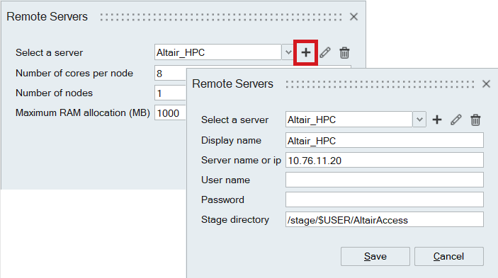

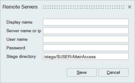

  • Add
    This option is used to add a PBS remote server.

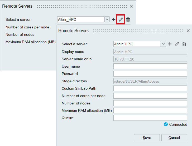

  • Edit
    This option is used to edit the selected server.

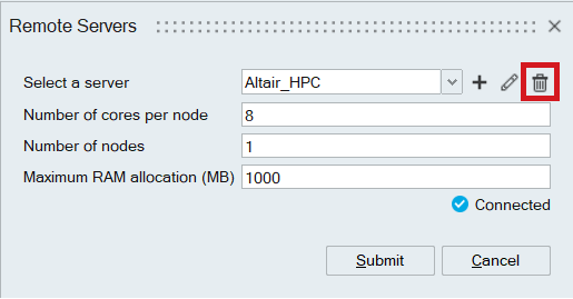

  • Delete
    This option is used to delete the selected server.

Step 1. Add a valid PBS server in Remote Server Settings dialog.

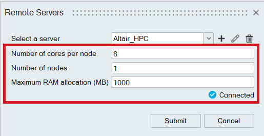

Step 4. It will open the following window. On the window, Enter the details and press “Submit” to start the job.
  • Number of cores per node - This option is used to specify the number of core per node for the job
  • Number of nodes – This option is used to specify the number of nodes for the job.
  • Maximum RAM allocation (MB) - This option is used to specify the maximum RAM memory.

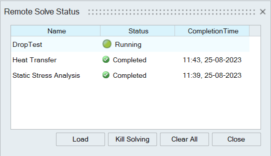

Step 5. After the job is submitted, you can track the jobs status in the below window .
