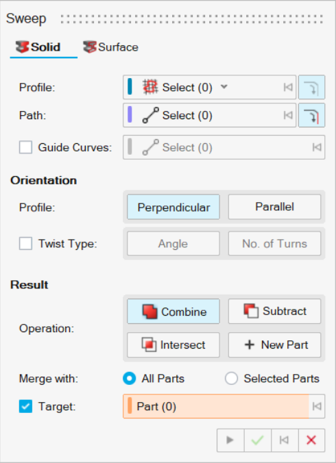

Sweep a profile along a path to create a solid or surface. Create a new part or combine, subtract, or intersect the swept shape with existing parts.
  1. On the Geometry ribbon, select the Sweep tool.
    Note: The tool may be hidden in the dropdown menu. To access the dropdown menu, you can do one of the following:
    • Select at the lower right corner of the currently displayed tool.
    • Click and hold the currently displayed tool.
    The guide panel appears.
  2. Choose the entity type that you'd like to create:
    • Solid: Sweep as a solid.
    • Surface: Sweep as a surface.
  3. Select a Profile. By default, Select is automatically turned on. Do one of the following:
    • If you selected Solid in the last step, select a closed sketch or a planar surface.
    • If you selected Surface in the last step, select a planar edge, closed/open sketch, or a planar surface.

  4. Choose a Path:
    1. Click the Select button.
    2. Select a sketch or an edge. The plane in which the profile lies must intersect the path. If the path extends beyond the profile, the sweep can occur in both directions.

  5. Choose the Type of sweep:
    • No Guide Curves: Don't use guide curves. You can add a twist to the swept shape.
    • Guide Curves: Add one to two guide curves. This allows you to refine the swept shape, but you can’t add a twist.

  6. Choose a Profile orientation:
    • Perpendicular (default): Orient the swept shape perpendicular to the path.
    • Parallel: Orient the swept shape parallel to the path.

  9. Choose a Result type:
    • Combine/Merge: Combine or merge the extruded shape with the existing parts.
    • Subtract (only available for Solids): Carve out the extruded shape from the existing parts.
    • Intersect (only available for Solids): Retain only the intersecting portions of the extruded shape and the existing parts.
    • New Part: Create a new part from the extruded shape.
  10. Choose a Merge method:
    • All Parts (default): Merge the extruded shape with all parts that touch the extruded shape.
    • Parts: Select the radio button to merge the extruded shape with selected parts. Then select the parts that you’d like to merge the extruded shape with.
