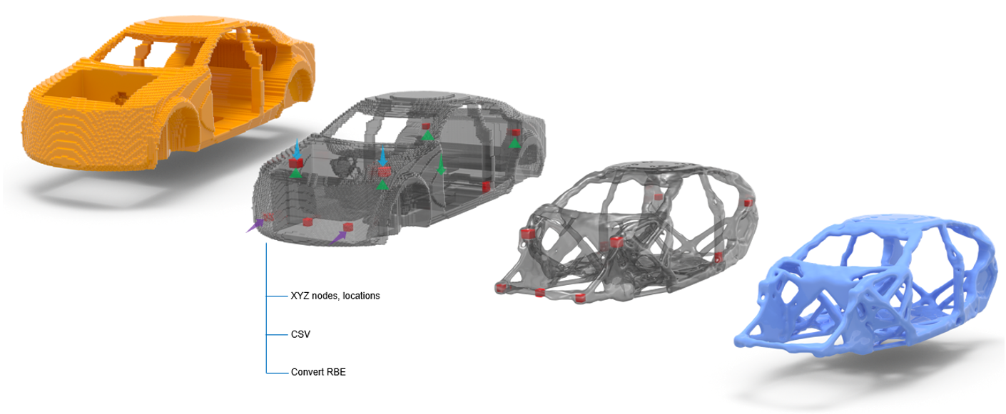

Create Hardpoints
Use the Hardpoints tool to define and manage non-design locations for topology optimization.
Once the hardpoint locations have been created, you can apply loads, boundary conditions, and the optimization problem definition. Once complete, topology optimization can be performed. It is recommended to have the loads, boundary conditions, and optimization problem definition in a separate include file for easy modular model setup.
From the Design Space ribbon, click the
Hardpoints tool.

Define hardpoints in one of the following ways.
Method Steps Manual Creation Define one or more locations using node selection or XYZ coordinates. - From the guide bar, select Nodes or Locations.
- Define one or more locations in the modeling window.
CSV Import Load hardpoint location data from a .csv file. - From the guide bar, click
Create from table.

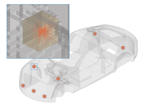

The locations are detected, the connector attachments are created, and the voxels in the design space are moved to a new non-design component.

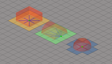

In the microdialog, select a shape.
Restriction: Shape selection is not available for RBE input.The capture options in the microdialog provide various settings to control dimensions and ensure accurate spatial capture.
During the creation process, a connector attachment is established at the selected location, and an RBE is generated to link all voxels within the defined capture region.
Figure 4.
The voxels attached to the newly created RBE are organized into a new component. The new component does have an appropriate PSOLID property assigned, but, no DTPL assigned, hence non-design for topology optimization.
