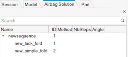

  7. On the guide bar, click Side.
  8. Select a node to define which side the airbag is folded on. In the case of a symmetric fold you have to select the side according to the initial fold line. The side for symmetric fold line is calculated automatically.
  9. On the guide bar, click Export to export the deck for the pre-simulation of the fold.
  10. At the end of the pre-simulation run, click the satellite icon to load the new positions from the resulting .h3d file.
