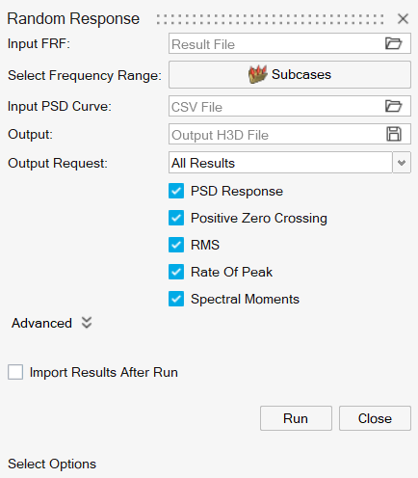

  1. From the Create tools, select Create > Random Response.
    Figure 1. Random Response Dialog

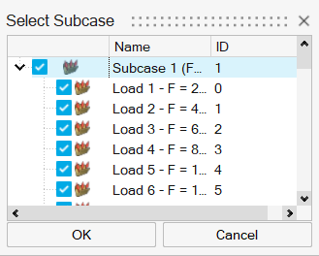

    1. For Select Frequency Range, click Subcases.
      The Select Subcase dialog opens displaying a list of complex subcases and their frequencies.
    2. Select one subcase and a preferred frequency range.
      Figure 2. Select Subcase Dialog
    3. Click OK.

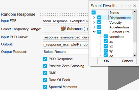

    Select Results
    Select preferred result data types and components to be exported in the output file. By default, all results are selected.
    Figure 4. Select Results
