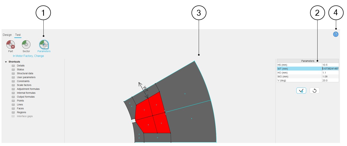

Below is the illustration of the Test environment and the “Parameters” modification function.
Table 1. Part Factory – Test environment - Simulate the change of the parameters in Motor Factory
1 Section of the first test function: Part to simulate the change of the parameters in Motor Factory.
It allows testing the robustness of the part when all its user input parameters are changed.
The user input parameter corresponds to the input parameter of the considered part to test.
2 User input parameters define the dimensions of the considered part to be tested.
3 The sector that represents the part is displayed on the central screen of the design environment of Part Factory.
In Part Factory, intersection of lines can be viewed.
Note: A right click on the mouse allows resetting the zoom if the part becomes invisible. This allows to export a picture in a *.png format.
4 Access to the online user help guide dedicated to the usage of the Test environment of Part Factory.
