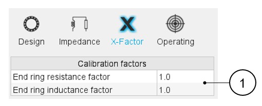

X-Factor
The calibration factors (X-factors) are user coefficients to tune the inter-bar end-ring resistances and inductances.
Table 1. End-ring - X-factor section
1 Calibration factors to be defined for the end-ring resistances and inductances.
These calibration factors are applied on both sides of the squirrel cage.
