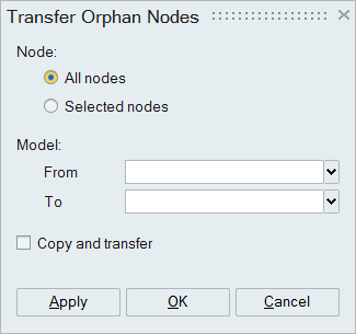

This tool is used to transfer orphan nodes from one model to another. You can either transfer all the nodes in a model or only the selected nodes.
Copy and transfer
If this toggle is on, it will copy the orphan nodes and transfer the copied nodes from one model to another.
