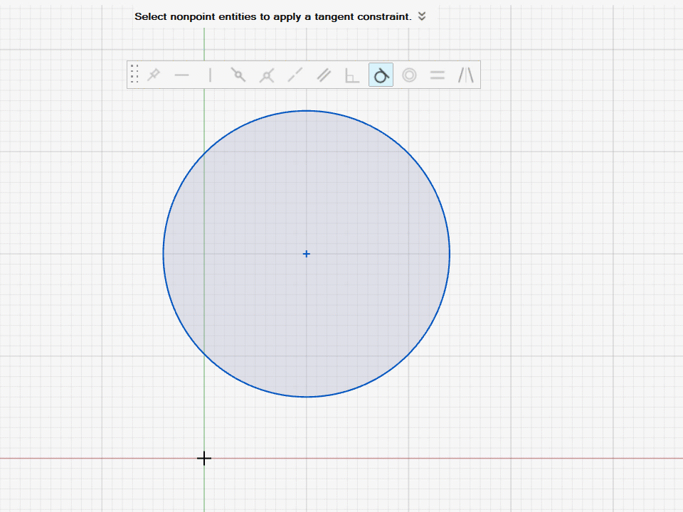

Tangent |
A line is constrained to be tangent to an arc, or an arc is constrained to be tangent to another arc. |

Tan/Tan | When you sketch a line between two circles, the Tan/Tan inference helps you make the line tangent to both circles. |
