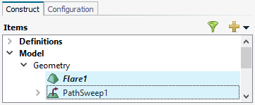

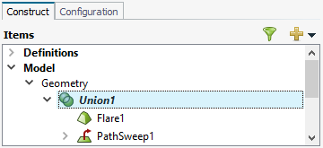

Union the flare and cuboid to create the horn.
Parts that touch, but are not unioned, are not considered to be physically connected and will result in an incorrect mesh.
