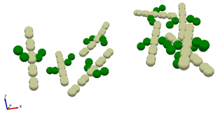

This tutorial describes the usage of the Bonding V2 model and focuses on the usage of Meta-Particles. It is intended for advanced users with a significant level of experience with EDEM.
Objective
The objective of this tutorial is to:
  • Use the Bonding v2 contact model
  • Set up and understand how particle contact radius works
  • Create a flexible element comprising multiple types of particles
  • Add a size distribution to flexible particles
