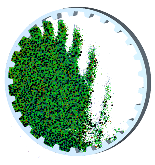

This tutorial decribes how to setup and analyze an EDEM simulation using the built-in Tavares UFRJ Breakage model.
The Tavares UFRJ Breakage model captures various body breakage mechanisms that occur during particle collision. They also include catastrophic breakage, using concepts such as size-dependency in breakage probability, and weakening by repeated stressing to deliver the final size distribution of the material.

In this tutorial, the Tavares breakage model is applied to a Semi-Autogenous Grinding (SAG) mill, which is a type of tumbling mill that uses steel balls as well as coarse ore particles as grinding media. This type of mill is widely used in the mining industry due to its ability to receive coarser particles and produce a finer product when compared to secondary and ternary crushers.
