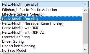

  4. In the Select Contact Models dialog box, select the following:
    • Select the Base Model from the Base Model dropdown list.

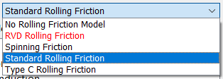

    • Select the Friction Model from the Friction Model dropdown list.

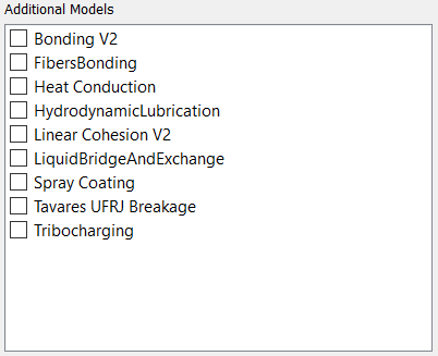

    • Select the Additional Model from the Additional Models dropdown list.
    Note: If Rolling Friction or Base model is not required, (for example if an API model has been used), select the No Base Model or No Rolling Friction Model.

  5. Optionally, select Edit Contact Chain to unselect Additional Models.

    EDEM is supplied with several integrated Contact models. You can also add custom plug-in Contact models, by selecting the checkboxes in the Edit contact models chain section. API models are displayed here if the custom model (.dll or .so file) is in the same location as the simulation .dem file or, if the folder is defined in Tools > Options > File Locations. The first location of the .dem file is selected followed by the folder defined in the Tools menu.
