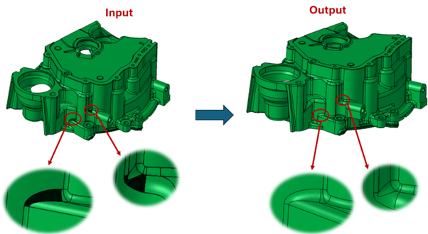

This is used to fill the holes present in the selected bodies, faces or edges.
Body
Fill the holes (free edge loops) present in the given FEM body.
Example
  • Input
  • Output
CAD (Parasolid)

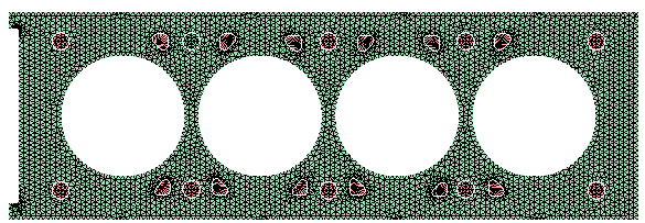

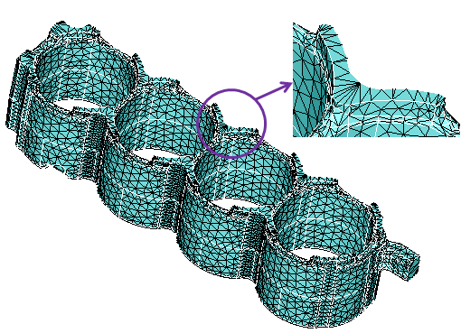

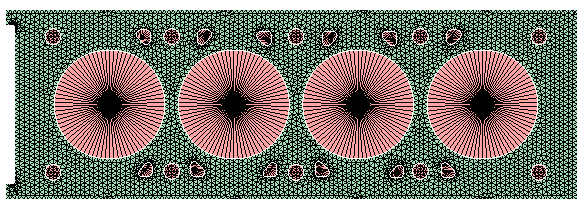

Face

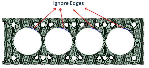

Fill the holes (edge loops) present in the given FEM faces. Loops that are associated with the ignore edges will not participate in the filling process.
Example
  • Input
  • Output (with ignore edges)
  • Output (without ignore edges)

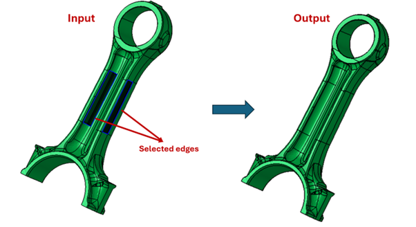

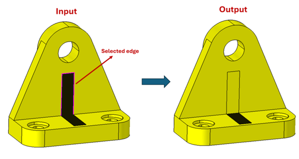

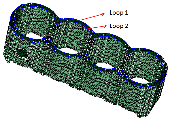

Edge
Fill the holes (edge loops) associated to the input edges.
  • Select Connected Free Edges
    Displays the free edge loops (holes) associated with the input edges. Using this option you can pick an edge and get the connected free edges.

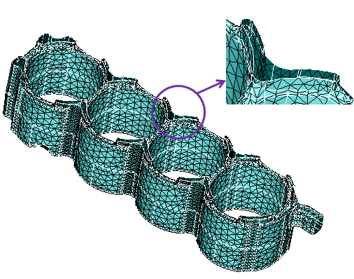

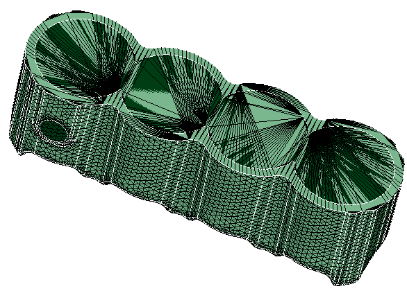

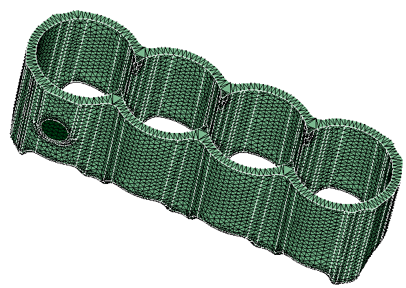

  • Single face
    This will fill all the edge loops as a single face instead of filling each edge loop individually.
    Example
    • Input
    • Output ( with single face)
    • Output ( without single face)
CAD (Parasolid)
Example

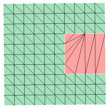

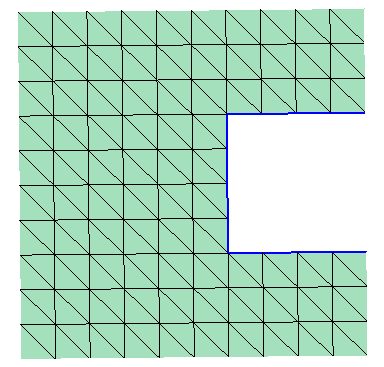

Fill partial loop
If the given input edges do not form a closed loop, this option closes the loop by connecting the two free vertices of the loop with the topological edge and then fills the loop.
Example
  • Input
  • Output
CAD (Parasolid)
Example

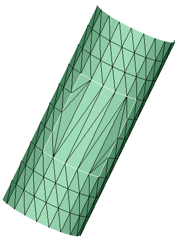

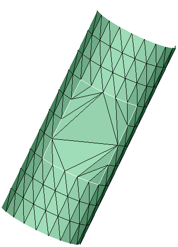

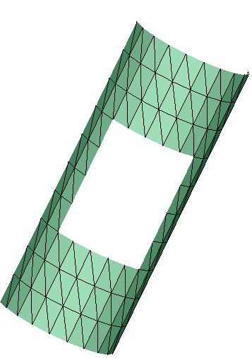

Cylindrical face
Fills the hole (free edge loops) on a cylindrical face. You have to pick an edge associated to the hole and the cylindrical face.
Example
  • Input
  • Output (with cylindrical face)
