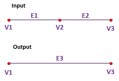

This tool is used to remove the floating vertex and merge the connected edges.
  • Floating Vertex
    Vertex connected to only two edges is called floating vertex.

Example
