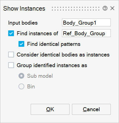

- Find instances of
Turn on this toggle to find the instances of the given reference bodies from the input bodies.
- Find identical patterns
Turn on this toggle to consider these reference bodies as a pattern and identify the identical patterns that resemble the reference input.

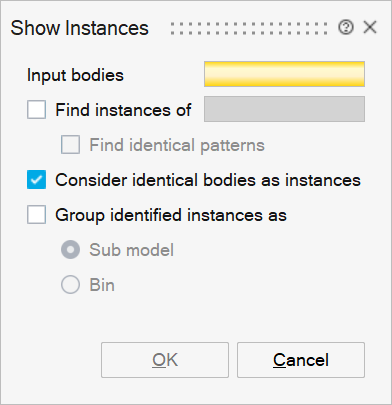

- Consider identical bodies as instances
In the case of CAD body input, turn on this toggle to find the identical bodies as instances.

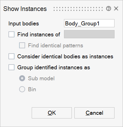

- Group identified instances as
By default, a group gets created for each instance group.
Use this toggle to create a sub-model or bin for identified instances.

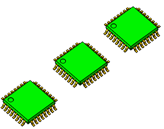

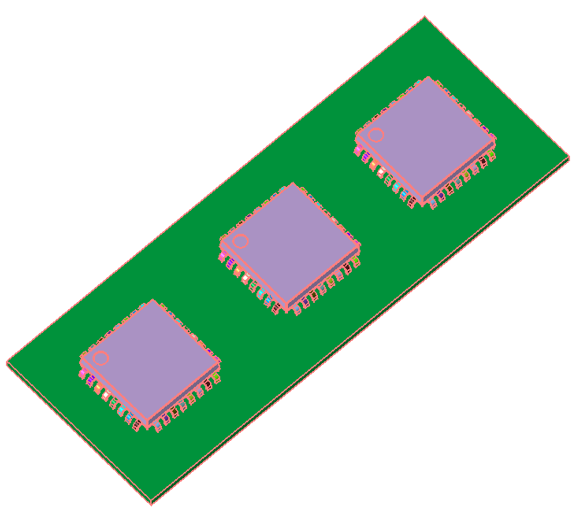

Example 1
It shows bodies in group display mode. The similar color represents instance bodies.
- Input
- Output

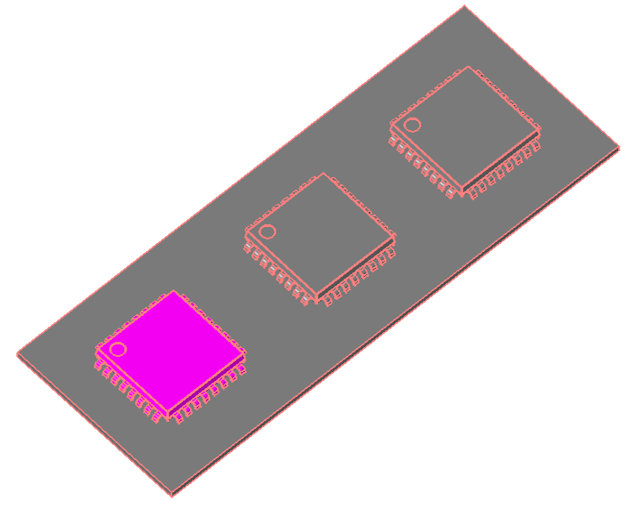

Example 2
It shows identical patterns based on the reference input. The similar color represents the identified patterns.
- Input
- Output
