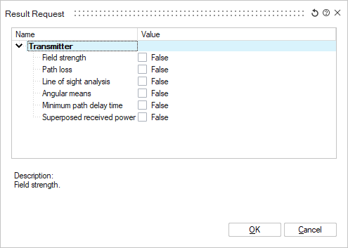

Result Request
Analysis > Options > Result Request
Select available result types by selecting the related check box.
Superposed Received Power
  • Incoherent Superposition (Power sum, Phase ignored)
    The ray contributions are summed up incoherently by adding the power values while ignoring the phases.
  • Coherent Superposition (Phase considered)
    The ray contributions are summed up coherently by adding the power values and taking into account the phases.
Angular spread (BS)/(MS)
  • Angular spread BS
    Request the angular spread on the base station (BS) side assuming an omni (isotropic) MS antenna pattern.
  • Angular spread MS
    Request the angular spread on the mobile station (MS) side assuming an omni (isotropic) MS antenna pattern.
Note: Received Power is always calculated by default.
