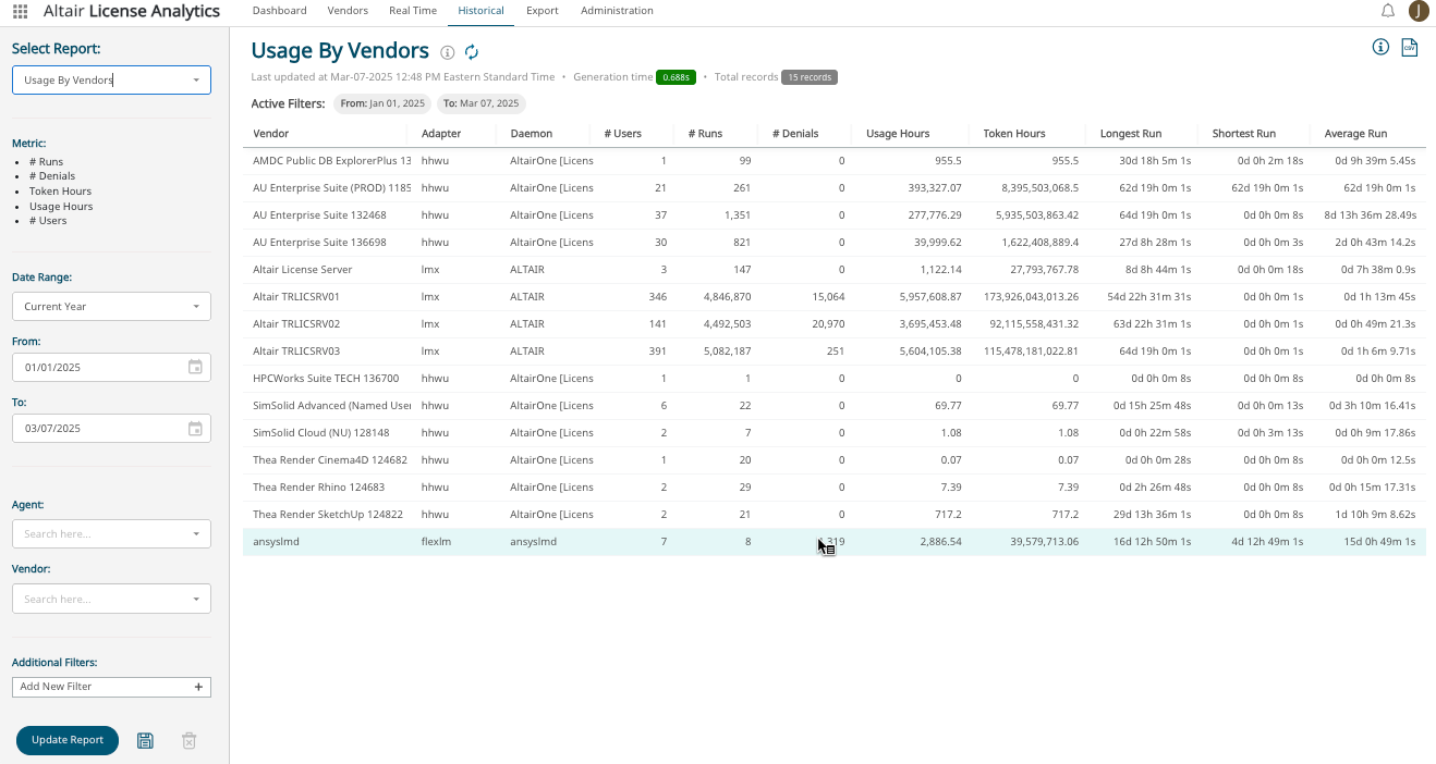

Usage By Vendors
This report presents various summary metrics segmented by vendors for a specified time period.
- Goal
- To compare utilization across various software vendors in terms of overall users, number of checkouts, hours used, etc. If competing software from different vendors is involved, this report can provide insight into how many users would need to be moved or trained if one software is chosen to replace another. It can also help identify underutilized software, aiding in decisions not to renew those licenses.
The report details are as follows:
| Name | Description |
| Vendor | Software |
| Adapter | The type of license server (flexlm, lmx, rlm, hhwu etc) |
| Daemon | The license server daemon name |
| Num Users | Number of Distinct Users |
| Num Runs | Number of NORMAL and BORROWED records |
| Num Denials | Number of denials |
| Usage Hours | Total hours used |
| Token Hours | Total hours used in terms of token hours |
| Longest Run | Longest checkout duration |
| Shortest Run | Shortest checkout duration |
| Average Run | Average checkout duration |
