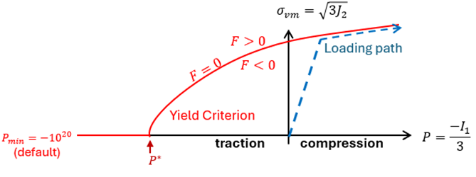

  1. An extended Drucker-Prager yield criteria can be defined as:
    J 2 = i f   P > P m i n   a n d     P > P *       J 2 = m i n   A m a x ,   A 0 ,   A 1 P + A 2 P 2                           e l s e                                               J 2 = 0
    Figure 1. Extended Drucker-Prager yield criteria

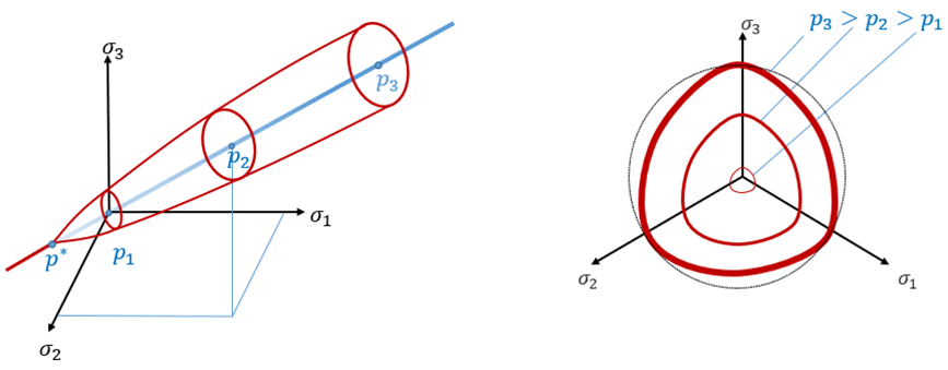

    From the Mohr-Coulomb parameters three different extended Drucker-Prager yield criteria can be calculated.
    Figure 2. Drucker-Prager Yield Criteria from Mohr-Coulomb Parameters
    The following values are computed: A 0 = k 2 ,   A 1 = 6 k α ,   A 2 = 9 α 2   MathType@MTEF@5@5@+= feaagKart1ev2aqatCvAUfeBSjuyZL2yd9gzLbvyNv2CaerbuLwBLn hiov2DGi1BTfMBaeXatLxBI9gBaerbd9wDYLwzYbItLDharqqtubsr 4rNCHbGeaGqiVu0Je9sqqrpepC0xbbL8F4rqqrFfpeea0xe9Lq=Jc9 vqaqpepm0xbba9pwe9Q8fs0=yqaqpepae9pg0FirpepeKkFr0xfr=x fr=xb9adbaqaaeGaciGaaiaabeqaamaabaabaaGcbaGaamyqamaaBa aaleaacaaIWaaabeaakiabg2da9iaadUgadaahaaWcbeqaaiaaikda aaGccaGGSaGaaeiiaiaadgeadaWgaaWcbaGaaGymaaqabaGccqGH9a qpcaaI2aGaam4Aaiabeg7aHjaacYcacaqGGaGaamyqamaaBaaaleaa caaIYaaabeaakiabg2da9iaaiMdacqaHXoqydaahaaWcbeqaaiaaik daaaGccaqGGaaaaa@49FE@

  3. Drucker-Prager yield criteria is given by:
    F = J 2 ( A 0 + A 1 P + A 2 P 2 )
    Figure 3. Drucker-Prager Yield criteria

    A 1 = A 2 = 0 MathType@MTEF@5@5@+= feaagKart1ev2aqatCvAUfeBSjuyZL2yd9gzLbvyNv2CaerbuLwBLn hiov2DGi1BTfMBaeXatLxBI9gBaerbd9wDYLwzYbItLDharqqtubsr 4rNCHbGeaGqiVu0Je9sqqrpepC0xbbL8F4rqqrFfpeea0xe9Lq=Jc9 vqaqpepm0xbba9pwe9Q8fs0=yqaqpepae9pg0FirpepeKkFr0xfr=x fr=xb9adbaqaaeGaciGaaiaabeqaamaabaabaaGcbaGaamyqamaaBa aaleaacaaIXaaabeaakiabg2da9iaadgeadaWgaaWcbaGaaGOmaaqa baGccqGH9aqpcaaIWaaaaa@3C2C@
    Yield criteria is von Mises ( σ V M = 3 A 0 MathType@MTEF@5@5@+= feaagKart1ev2aqatCvAUfeBSjuyZL2yd9gzLbvyNv2CaerbuLwBLn hiov2DGi1BTfMBaeXatLxBI9gBaerbd9wDYLwzYbItLDharqqtubsr 4rNCHbGeaGqiVu0Je9sqqrpepC0xbbL8F4rqqrFfpeea0xe9Lq=Jc9 vqaqpepm0xbba9pwe9Q8fs0=yqaqpepae9pg0FirpepeKkFr0xfr=x fr=xb9adbaqaaeGaciGaaiaabeqaamaabaabaaGcbaGaeq4Wdm3aaS baaSqaaiaadAfacaWGnbaabeaakiabg2da9maakaaabaGaaG4maiaa dgeadaWgaaWcbaGaaGimaaqabaaabeaaaaa@3D1C@ )
    The polynomial expression should have at least one root and should be increasing.

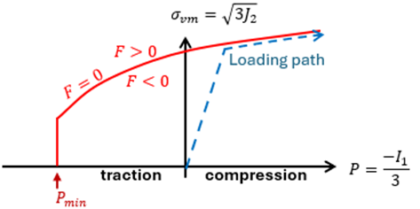

  6. When the cut-off pressure P m i n is reached or the root P * on pressure axis is reached, the yield surface degenerates to 0 (deviatoric stress is consequently nullified).
    Figure 4. Drucker-Prager Yield criteria with P m i n
